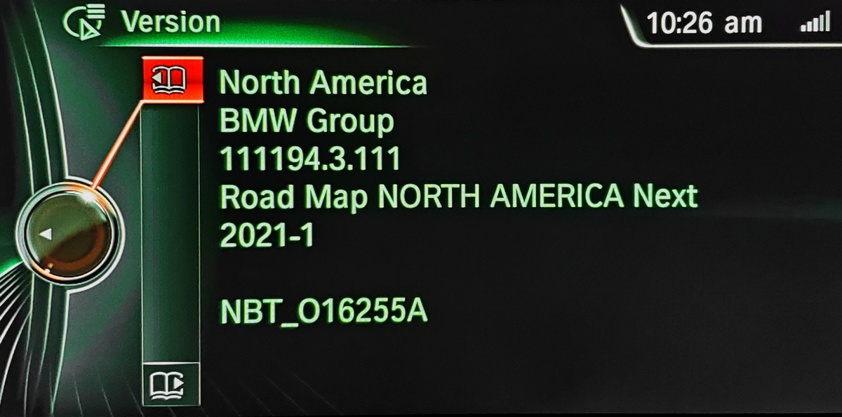

Links to 2 separate shares are in the 1st post. Download both of them.
>>> Generating FSC code for map updates - BMW_CIC_FSC_Generator.exe <<<
Note:As of 08-16-20, 2021-1 missing from the Maps drop down menu. 2021-1 info missing in Lookup.xml
Below is untested since I already have a lifetime code but you can try it out: Copy & paste to Lookup.xml file
<SgbmId id="NAVD_000014B8_255_005_194" SWID_FscShort="00A8004D" name="Road Map NORTH AMERICA Next 2021-1" supplier="NTQ" sop="01.06.2020" version="10_09" MapOrderNumberBMW="" MapOrderNumberMINI="" MapOrderNumberRR="" successorMapOrderNumberBMW="" successorMapOrderNumberMINI="" successorMapOrderNumberRR="" NextNo="01474">
<EcuVariant CompatibilityIdentifier="NBT-HB" Format="CIC" />
<SwUpdate SwUpdateEntry=""/>
</SgbmId>
Note:As of 09-12-20, 2021-1 is available from the Maps drop down menu

270
Drives: ///M6 GC

One word of caution - the 2021-1 No longer fits on a 32GB drive. Despite variety of formatting options I kept getting an error that the drive was ~400MB too small. You need 64GB or bigger USB for this update.

Thanks! I got this to work!
The 2021-1 info for Lookup.xml worked great, so thank you also for posting that
Was missing a few files at the beginning, but once i figured out my issues I got everything working!

Originally Posted by walmark View Post
This is fantastic, it worked perfectly. Thank you BadSeed!
I used a 32GB Patriot RAGE XT drive.
Thanks for testing.
