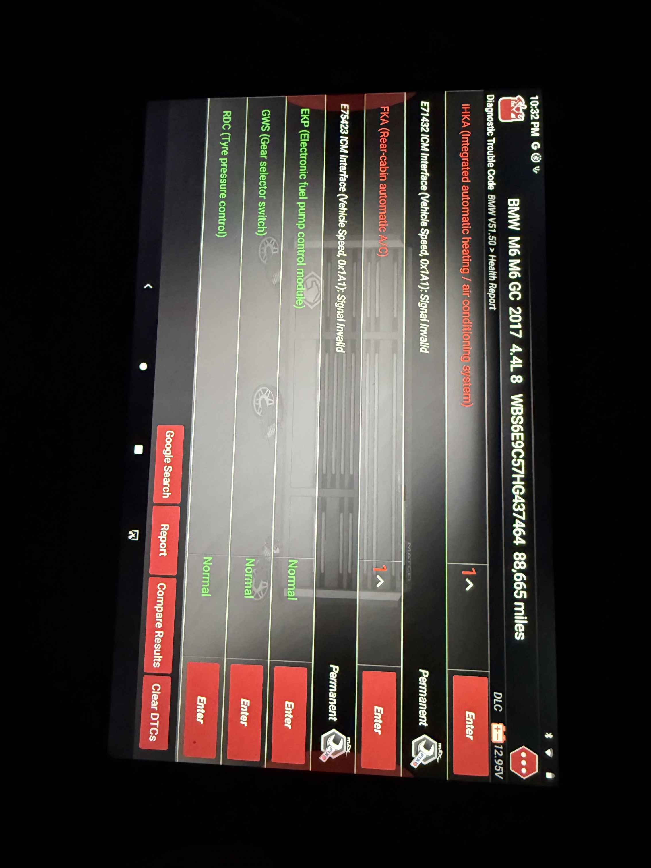

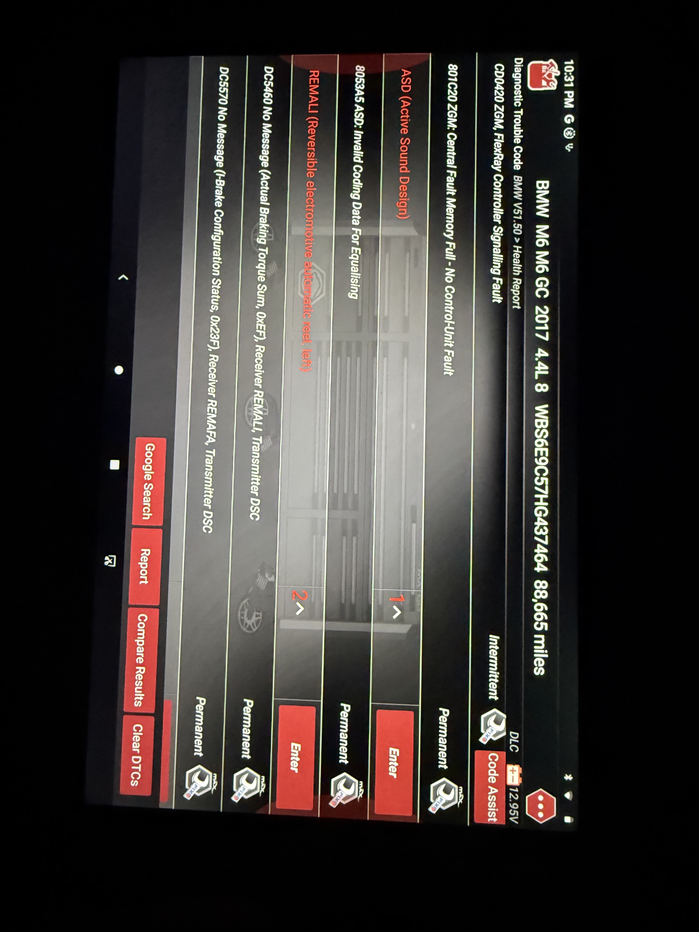

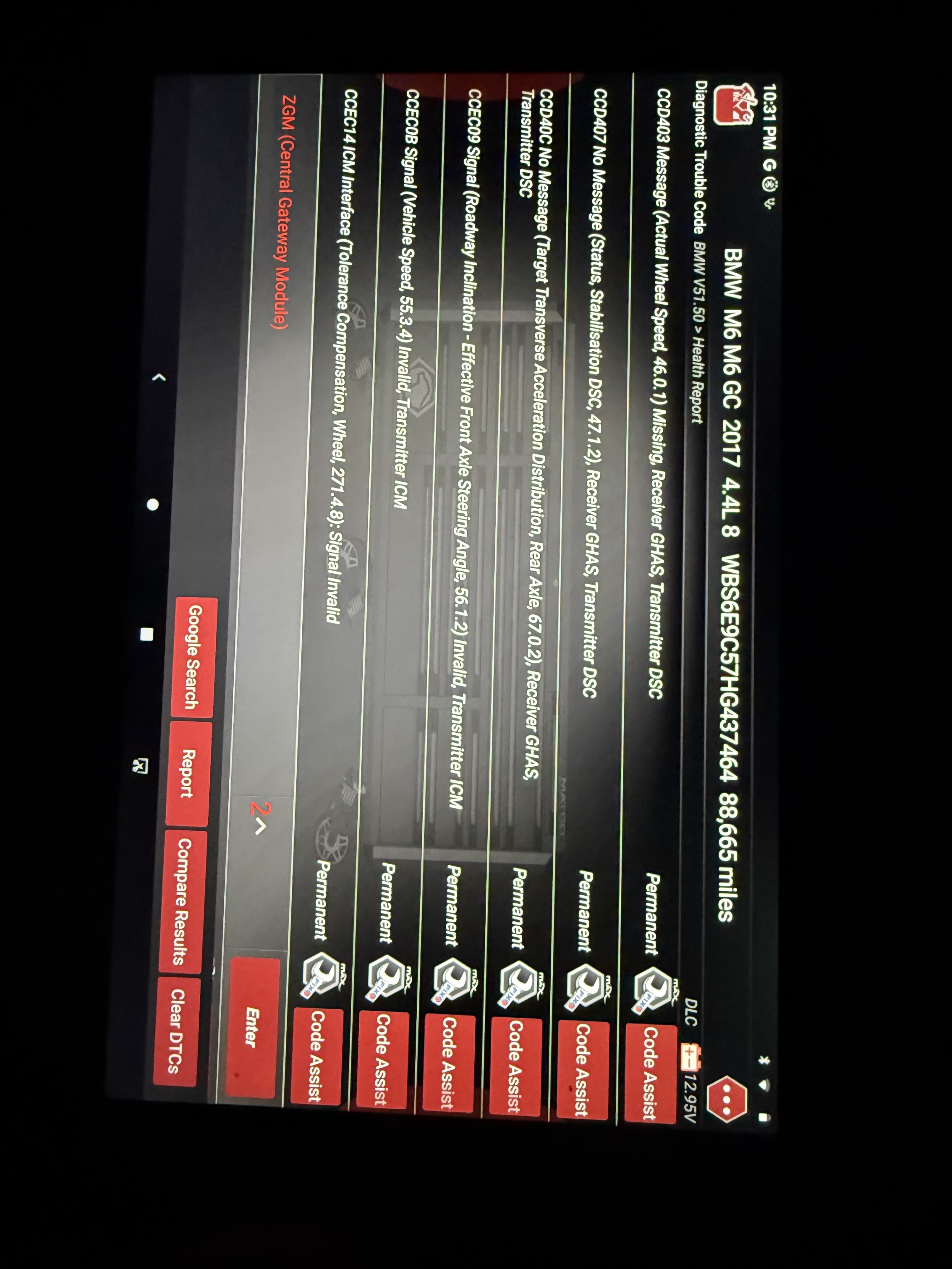

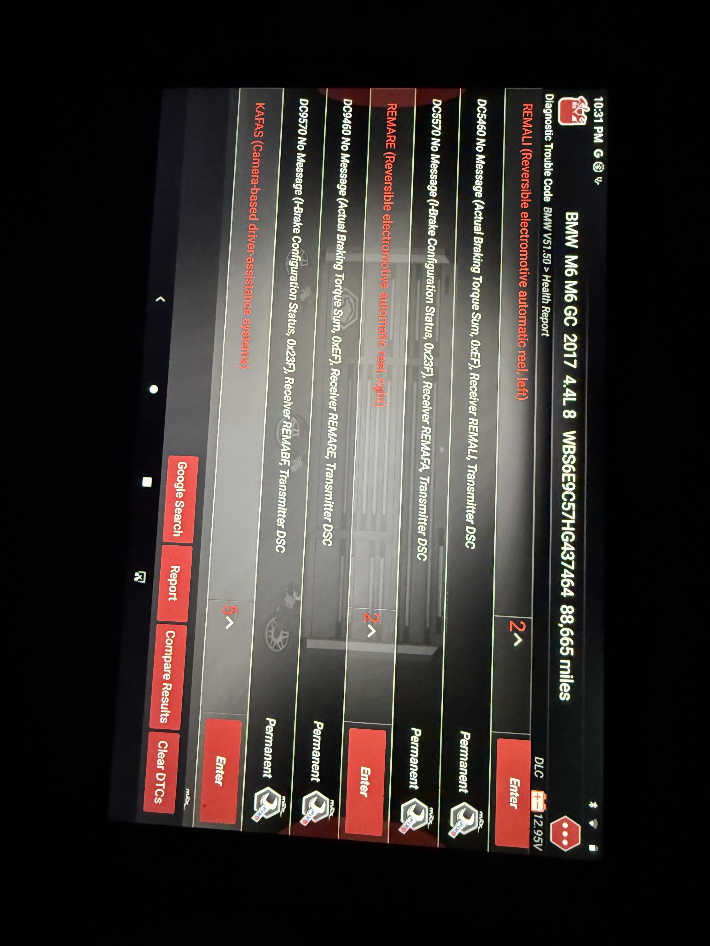

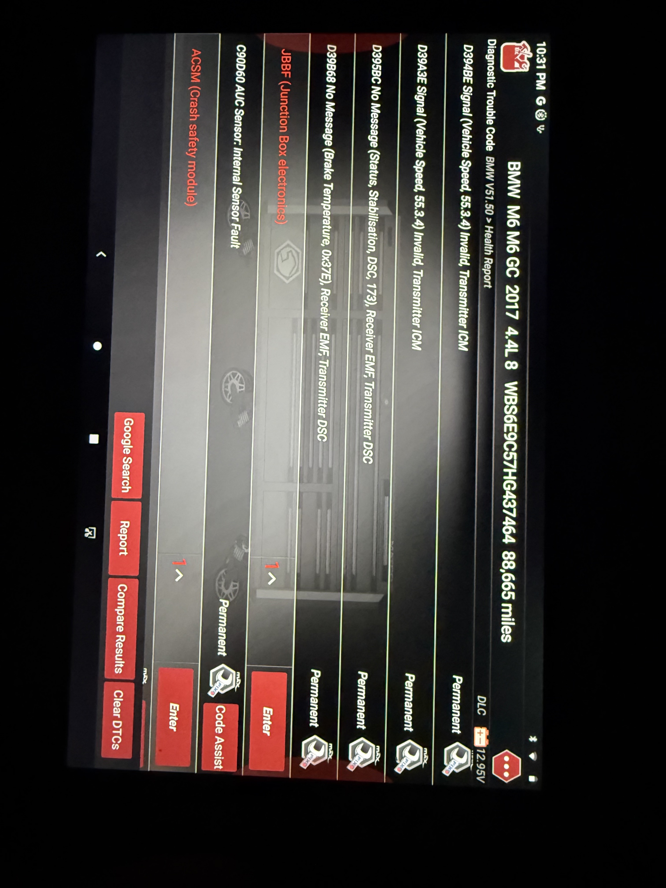

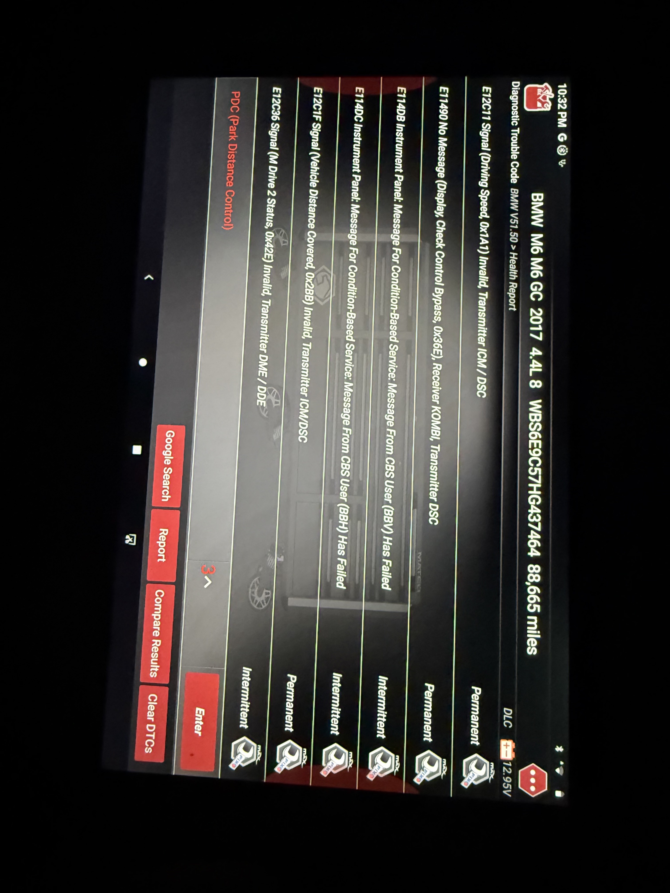

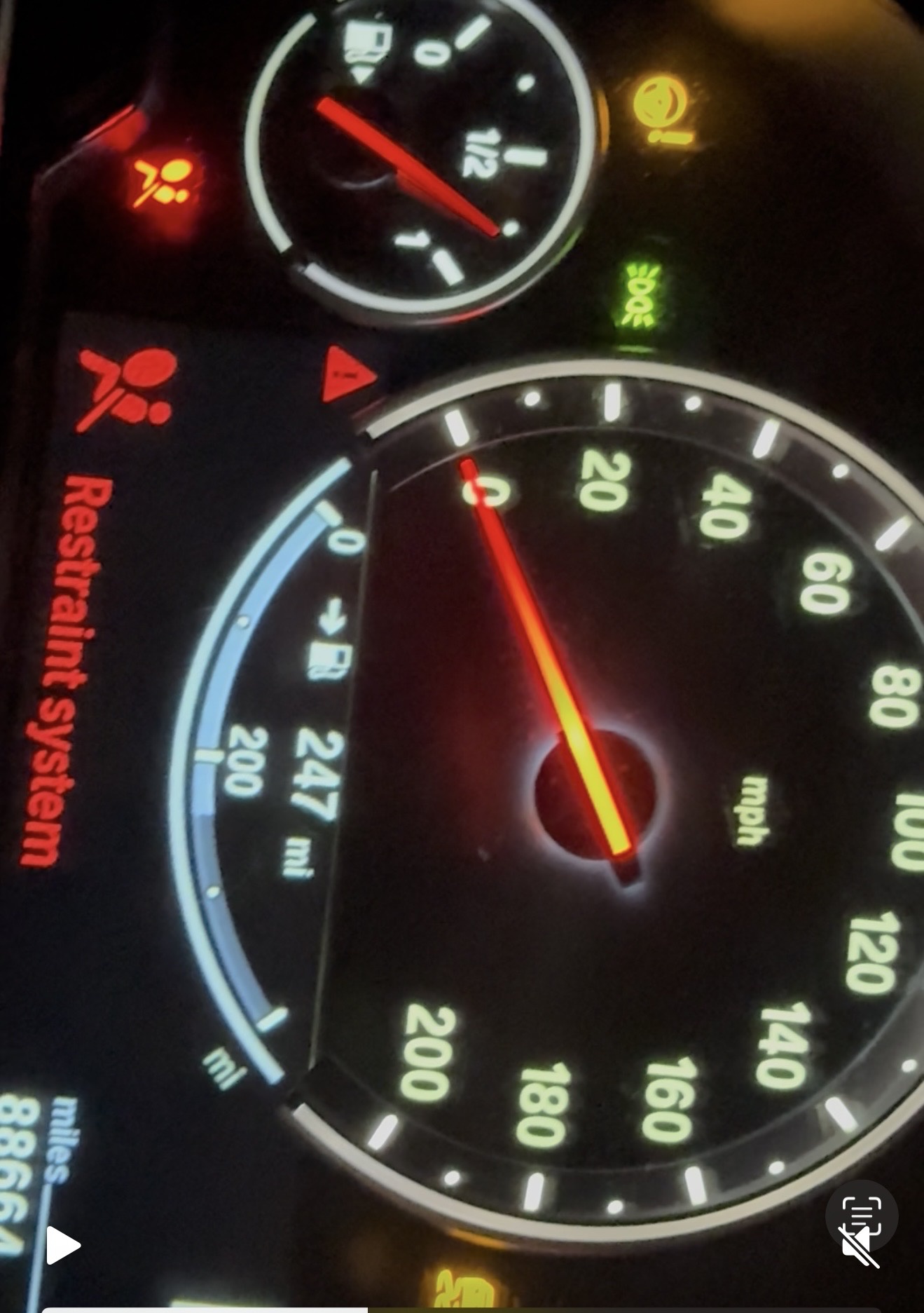

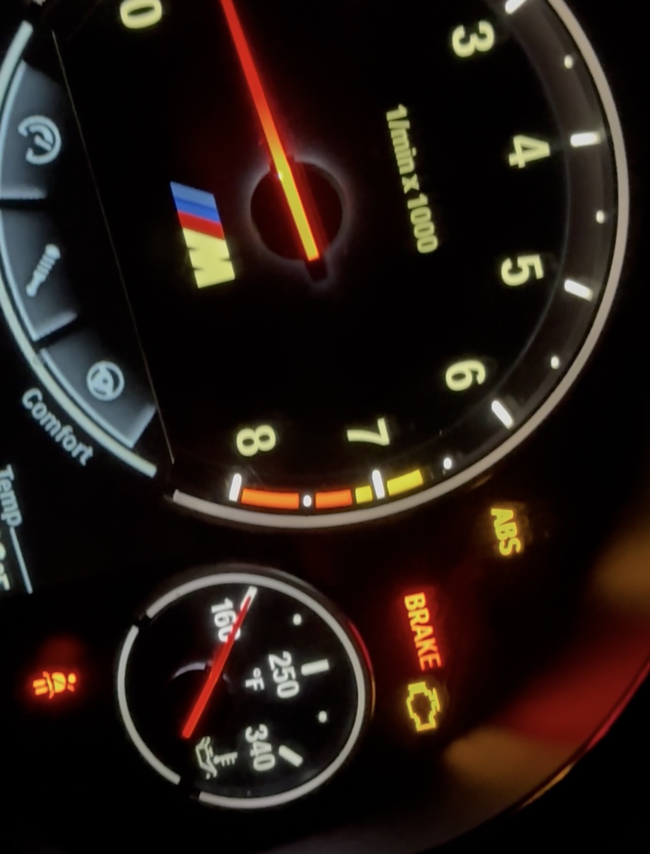

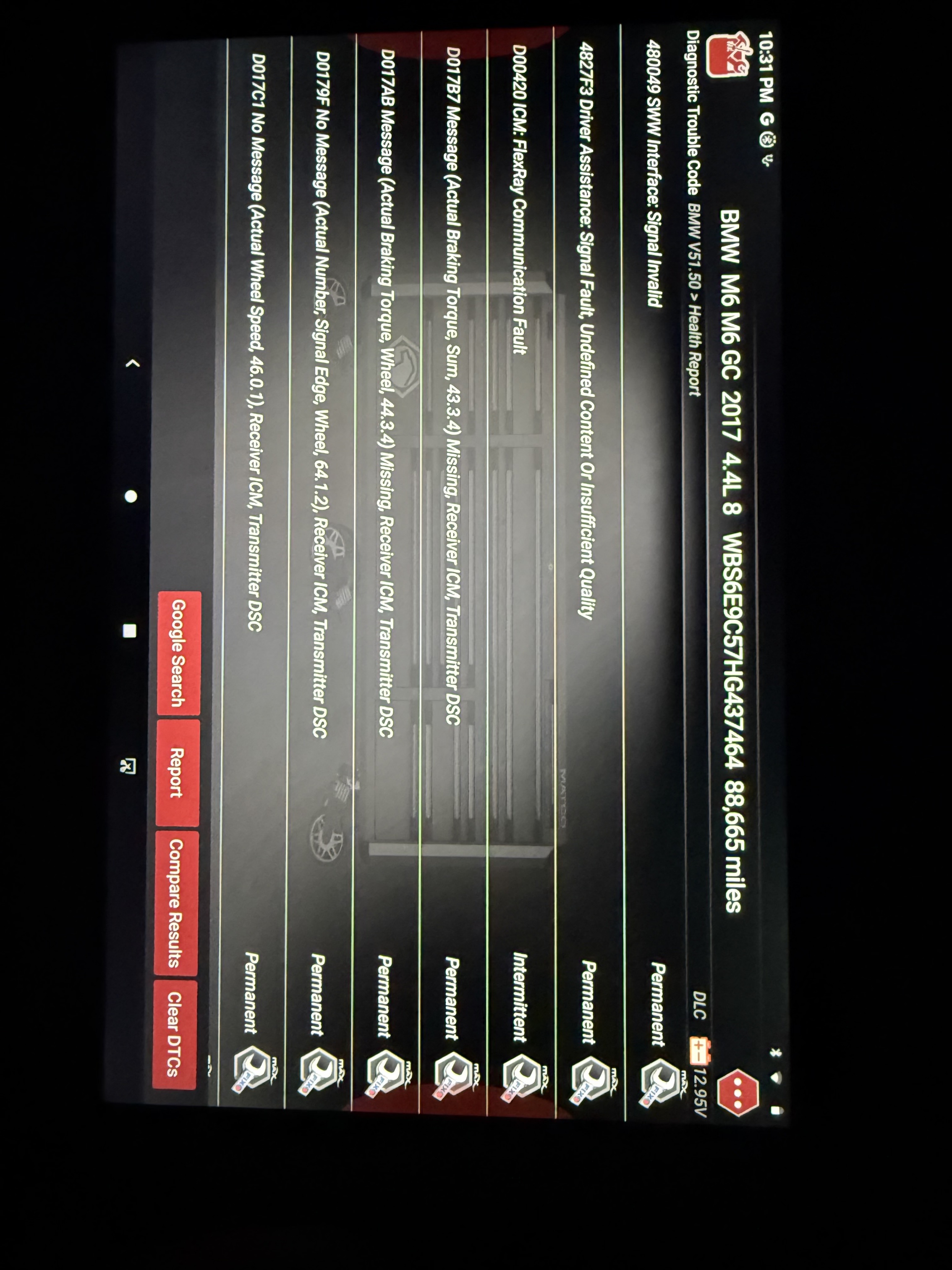

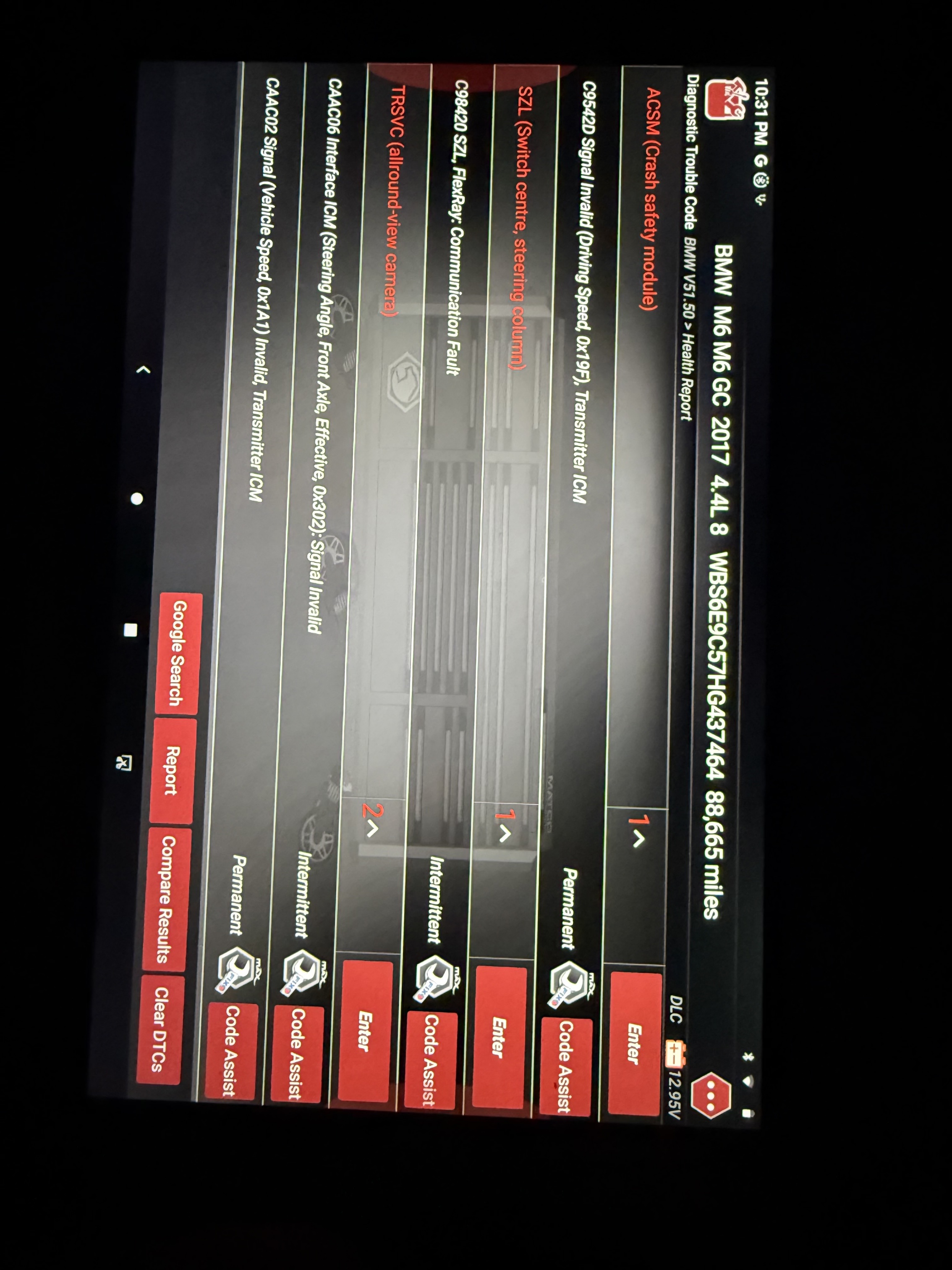

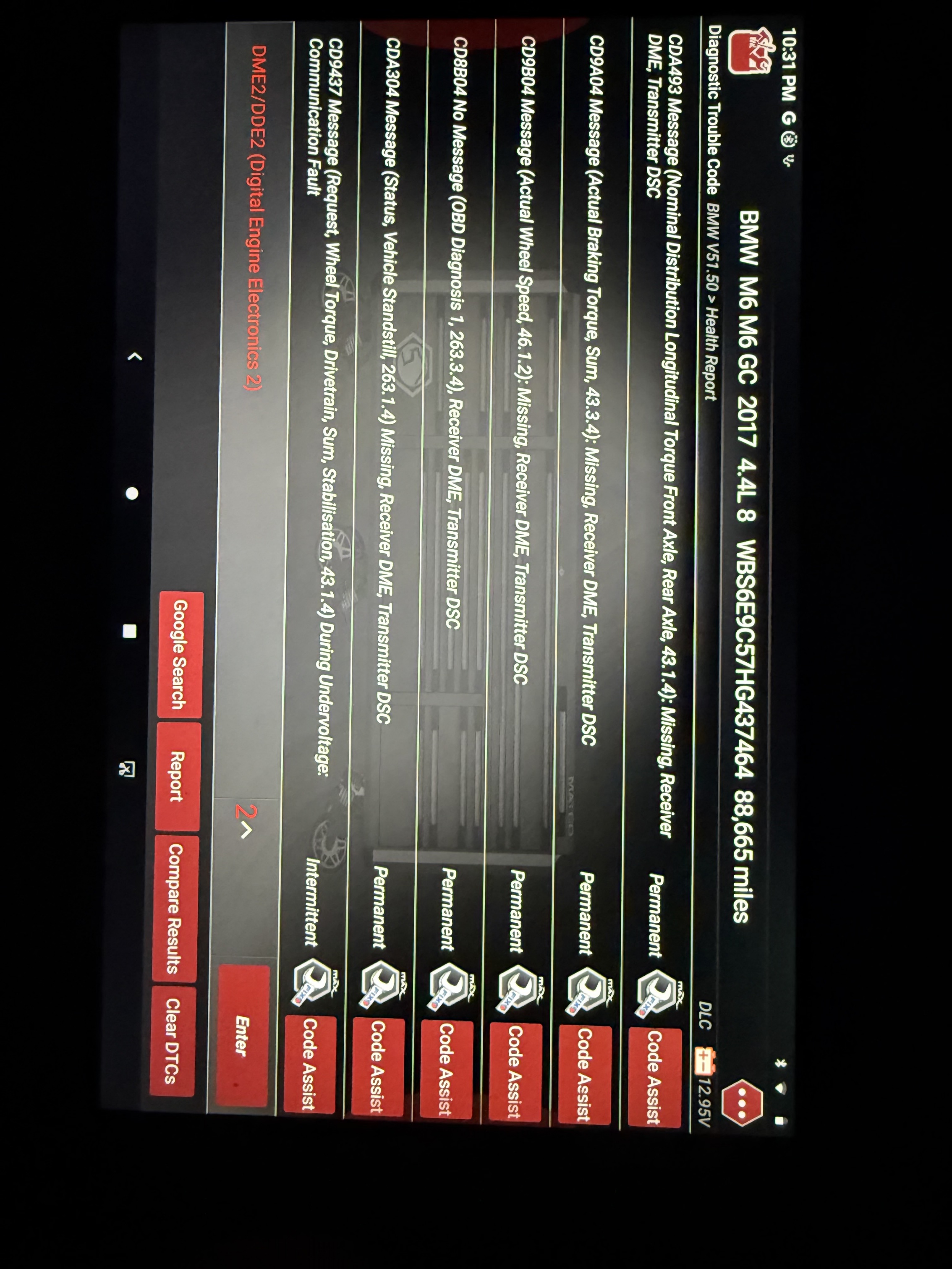

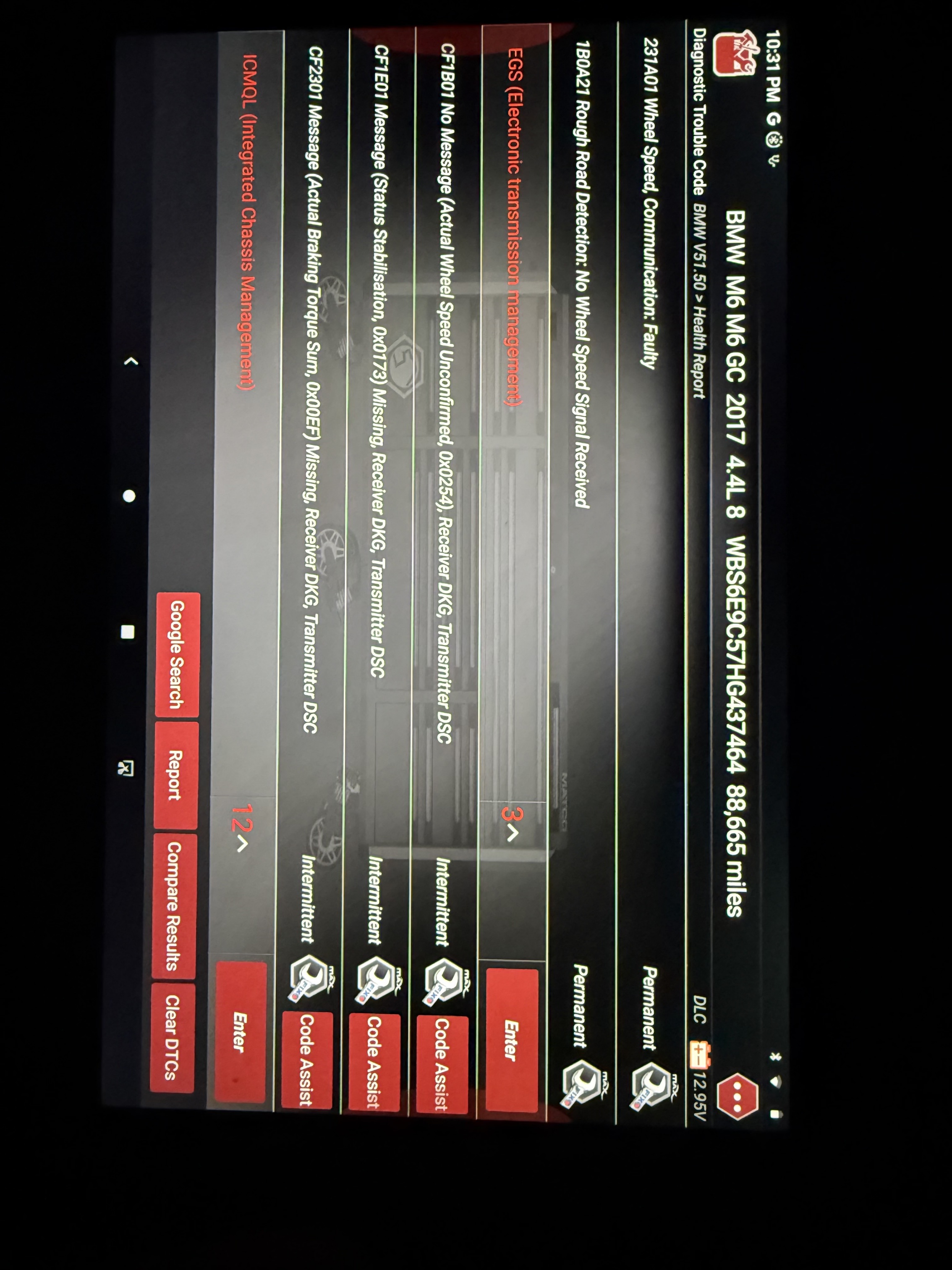

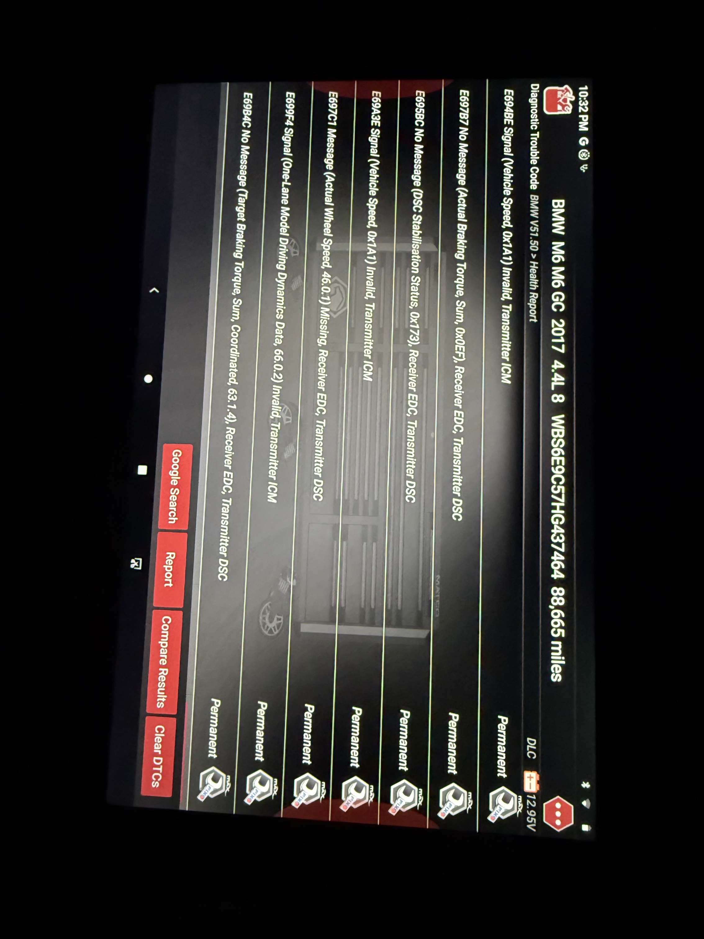

I had a message that stated battery discharge. I drove the car for a few miles and decided to buy a new OEM battery. I didn't immediately change the battery and the car sat for one day without starting or driving the car. When I started the car, I had numerous lights on the dash appear. The abs, the brake light, the air bag light, the steering light, check engine light, and traction control light were all on. I replaced the battery and registered it with the car. When I turned the car on, all the dash lights were still on. I decided to try and take it for a drive and when I put the car in drive, the car turned off. Does anyone have any ideas of what could be wrong? Or any solutions? Thank you in advance!

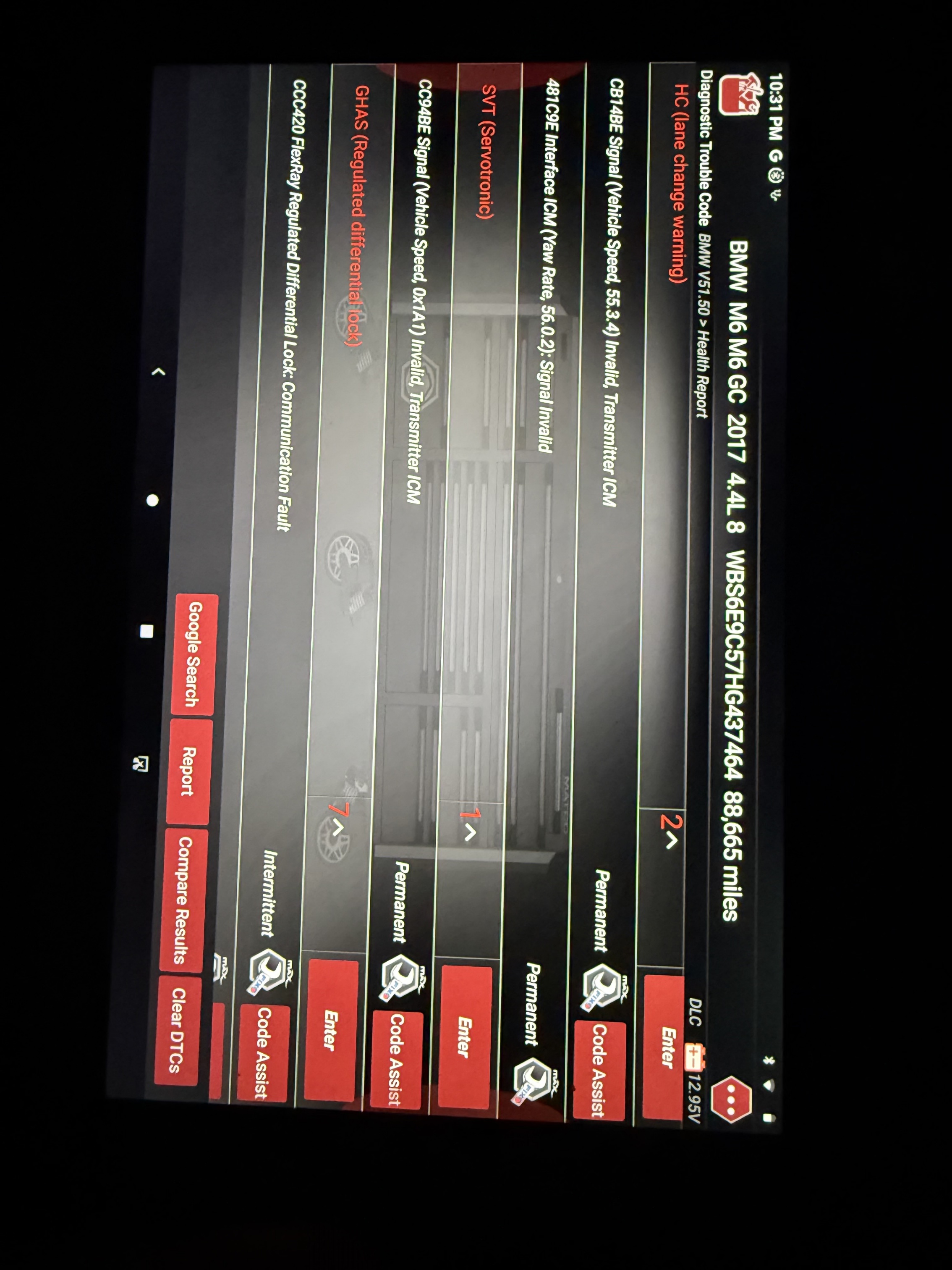

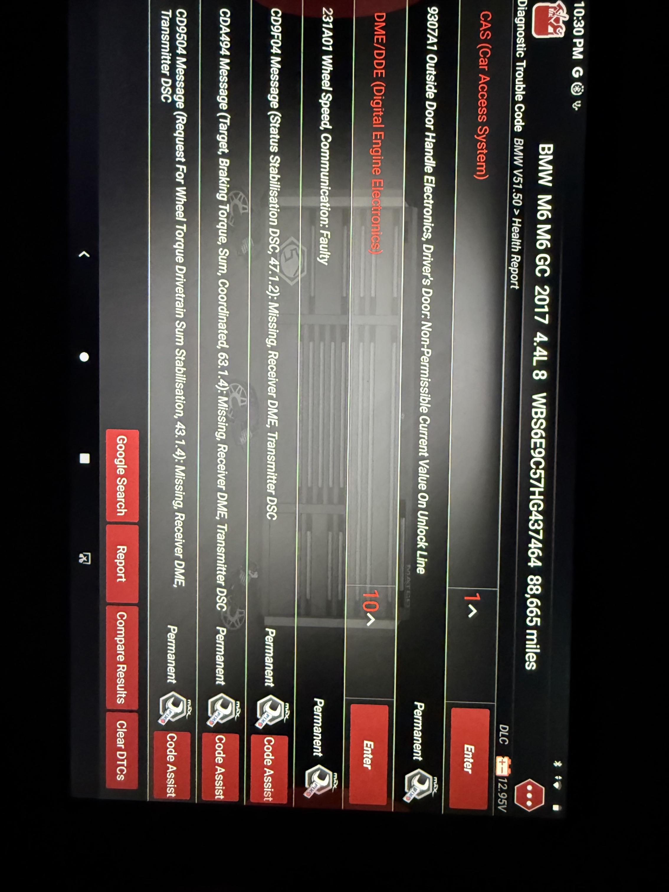

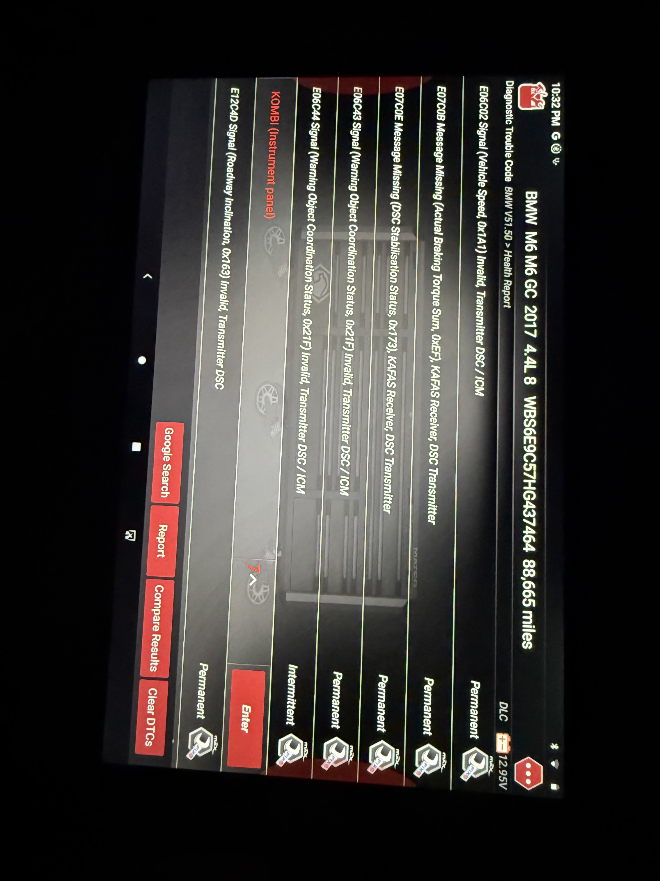

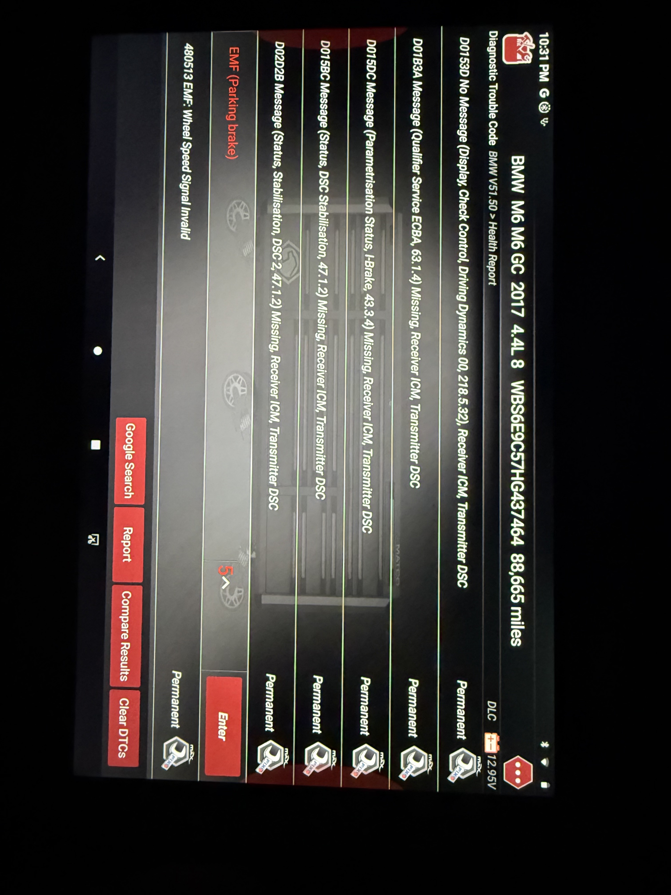

Have you checked for any DTC's? That would be helpful to know what codes are set.

L337TurboZ yes a bunch of them ...

TinCanSailor I needed a new door handle comfort touch was bad so blew fuse #2 in glove box, replaced door handle and fuse, everything fixed
