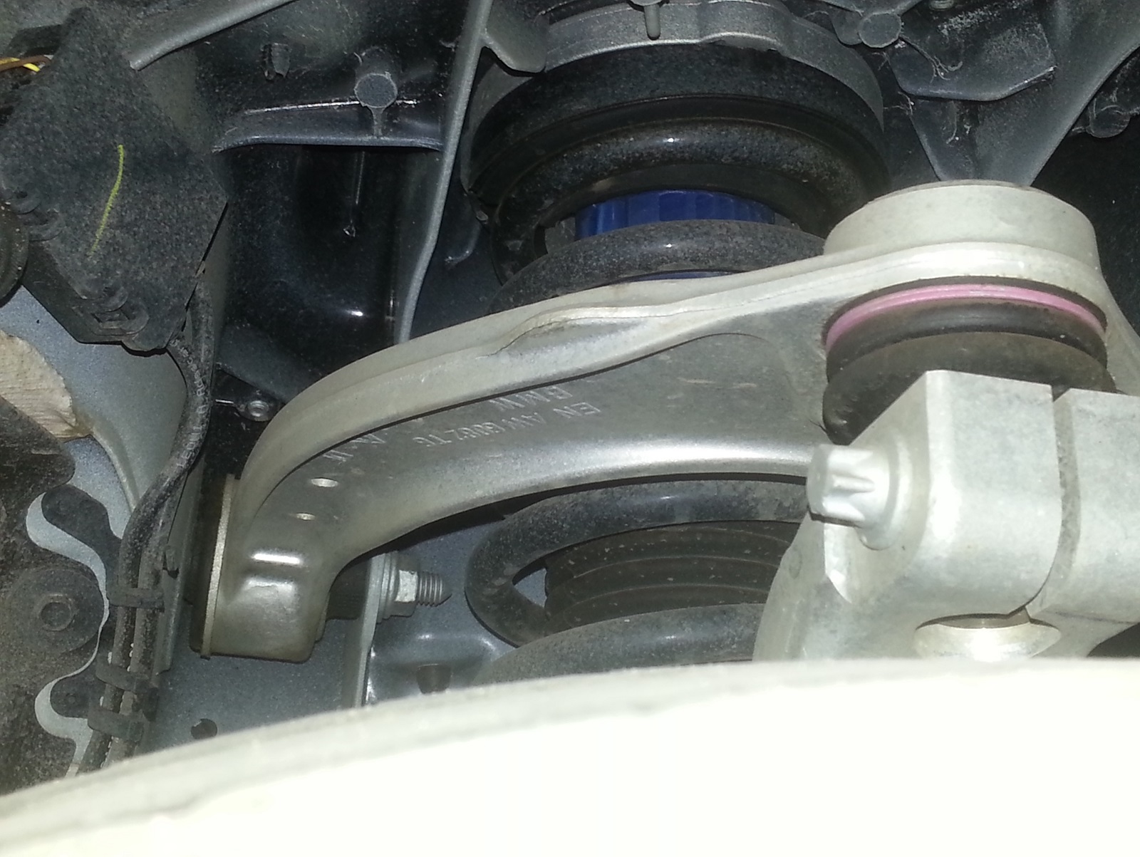

is the blue thingy shipping blocks?

They look a bit like this below. They fit into the springs.
