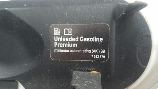

My gas cap door says to use 89 octane fuel.
Hmm, I thought these cars were premium for sure. I'll have to look at my owner's manual. I don't think my car has a filler door label.
Oh, that's the minimum, not the recommended.

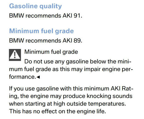

So here is what the operation manual says:
Given this advice, I generally use 89 unless it's in the heat of summer even though BMW says "This has no effect on engine life."
Well, you save a few bucks that way. Probably more than a few.
