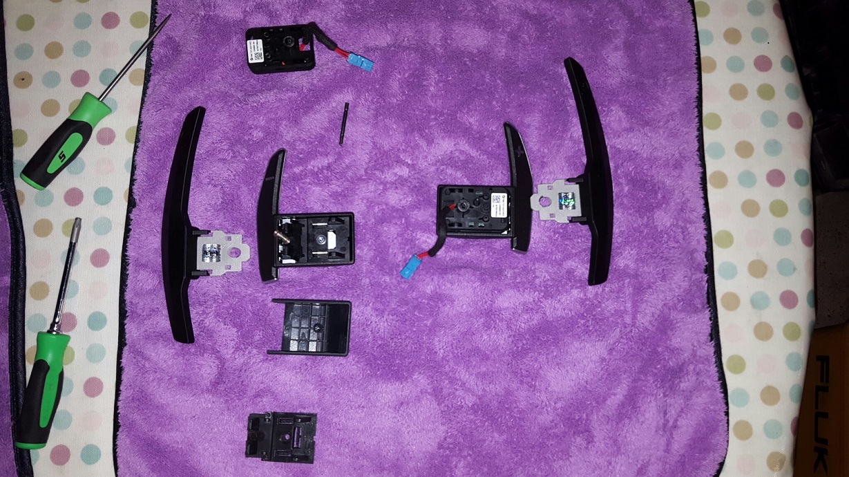

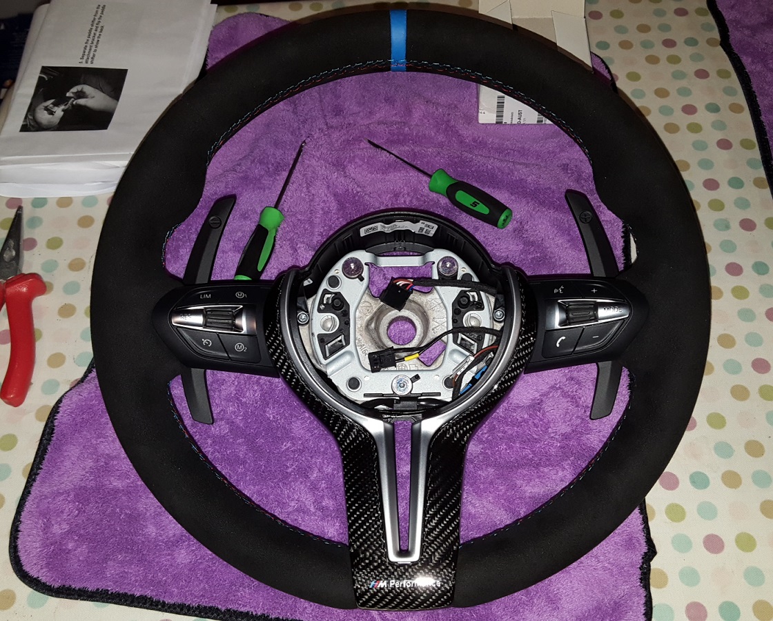

Finished this mod just before christmas, so thought I should post it....
I bought my F06 M6GC 12 months ago and when the cold weather came I was peed off I forgot to order the heated steering wheel option (ok, a small problem, but it still got under my skin).
So I though - could be a project? Retrofit the optional heated wheel maybe? I wanted to get the BMW Performance full alcantara wheel, but that isn't available heated - and it costs a shed load of money.
1... I bought a standard M6 heated wheel and had it retrimmed by an expert UK trimmer (royalsteeringwheels.com) in the exact same shade of black alcantara and blue leather stripe as used by BMW suppliers, same tri-colour stitching (maybe better quality too), so it looks as good as OE but is still 2/3 the price of BMWP wheel from BMW and it's heated!!
2... Bought the column switch for wheel heating, small loom and the wheel controller module
3... Also bought the BMWP carbon steering wheel trim
4... Also bought extended paddles in matt black from Autotecknic (while i'm at it...)
5... Fitted it all - easy!
Well, not so easy, my car didn't have lane departure so there is no power supply to the wheel for the "vibrator" which is the same supply for heating.
I had to do a lot of research on the wiring and circuitry and make up a extra lead (pins not present in switch cluster) all using BMW parts though.
6... Code the car for the new option: Add option 248 to the VO. Indicator switch cluster is a codable module "SZL" and it handles the heating commands.
7... Hey presto! cosy warm hands and a unique heated alcantara wheel!!

Hi dbakez,
You need to use spare pins on the airbag socket to get the new supply into wheel and onto the heater control module as per circuit diagrams.
Some people run a new supply from the supply system in the footwell, but it was too difficult for me. I just use the supply from the cigar lighter in the centre armest. Is it an ignition on 12v supply.
So I added 2 new wires into the back of the SZL module then ran them behind the centre console trim and into the armrest cubby hole then attach a cigar lighter adaptor and plugged it in. bingo.

I didn't remove the cubby hole liner, I ran the wires from the steering column and in behind the leather side trim on the centre console on drivers side then popped it into the cubby hole where i put a cigar lighter adaptor plug on the end and plugged it into the cigar socket, not disturbing the car wiring. Mines a lease car so it needs to be easy to remove when it goes back!
CF steering trim is official BMW part. Item 2 here http://www.realoem.com/bmw/enUS/show...diagId=03_0099
Also DCT shifter cover in carbon. http://www.realoem.com/bmw/enUS/show...diagId=03_0064

You can get the paddles off with the wheel on, but you have to remove the airbag first, but once you've done that its only a 30 second job to take the wheel off. One centre bolt, undo a couple of connectors and it lifts straight off (it's keyed so you can't put it back in the wrong position)
Then its much easier to work on the wheel on a bench.
